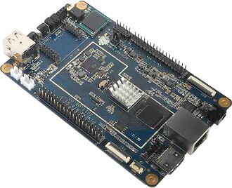

PINE A64-LTS
A PINE A64-LTS with eMMC.
Manufacturer PINE64 (Pine Microsystems Inc.)
Architecture AArch64
Bootloader Upstream U-Boot[1]
Boot order SD, eMMC, SPI NOR Flash
Maintainer
Note: While made by the same manufacturer and using an Allwinner SOC, the PINE A64 (non LTS) does not use the same bootloader.
The PINE A64-LTS is an affordable "Long Time Supply" single board computer built around the Allwinner R18 SOC.
It can boot from SD or from an eMMC.

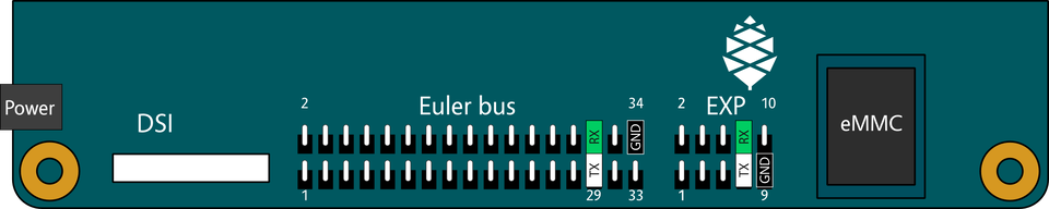

Serial console
Follows a simplified drawing of the edge of the Pine A64-LTS, with two locations to tap for serial.[2][3]
EXP Connector
Pin Function
7 UART0_TX
8 UART0_RX
9 GND
Euler "e" Connector
Pin Function
29 UART0_TX
30 UART0_RX
33 GND

To connect the Pine A64-LTS to the computer in FEL mode, you will need a USB A-to-A (male to male) cable, and plug to the upper USB port[4].
Once started in FEL mode, the computer should see the following device.
