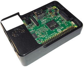

| !colspan="2" class="title"|Raspberry Pi 3 Family | | ! colspan="2" class="title" | Raspberry Pi 3 family |
| |colspan="2"|[[File:raspberry_pi_3_glamour.jpg|frameless|256px|A Raspberry Pi 3 with enclosure.]] | | | colspan="2" | [[File:raspberry_pi_3_glamour.jpg|frameless|256px|A Raspberry Pi 3 with enclosure.]] |
