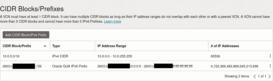

To set up IPv6, your Virtual Cloud Network (VCN) must have an IPv6 prefix assigned.

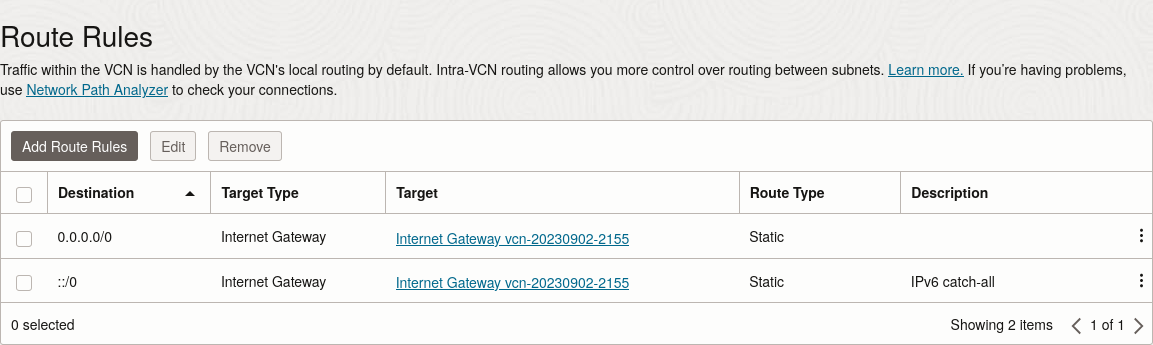

The VCN's Route Table(s) must have an entry for IPv6 traffic.

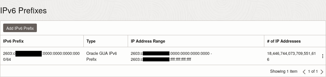

The VCN's subnet for your instance must have an IPv6 prefix assigned.
