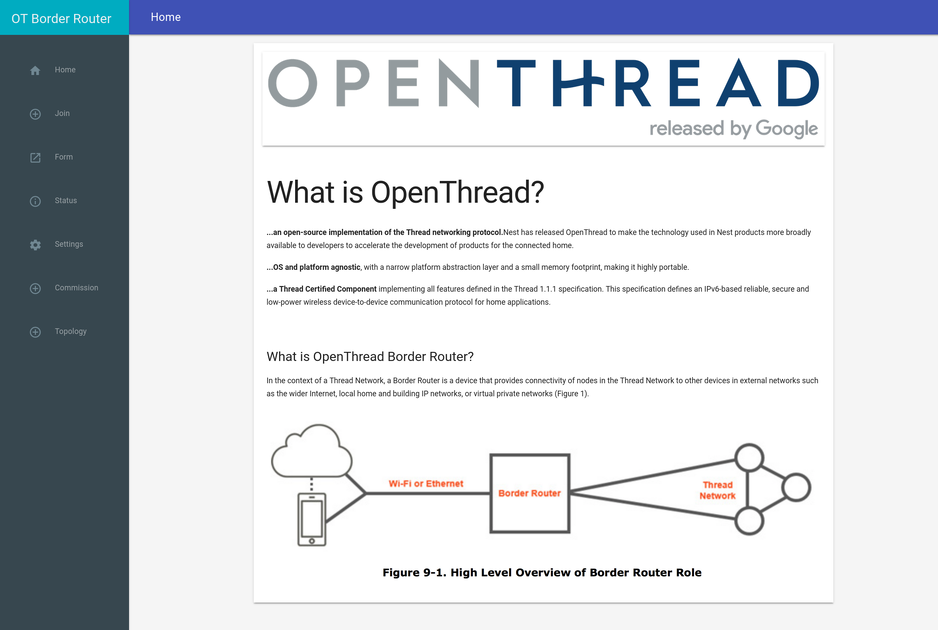

once the service is started you should be able to access the web ui
You can use the UI to form your own network or join an existing network provided you have the credentials for it. The module also installs the ot-ctl CLI tool which can achieve the same actions and allows for a deeper inspection of the thread network and routing tables

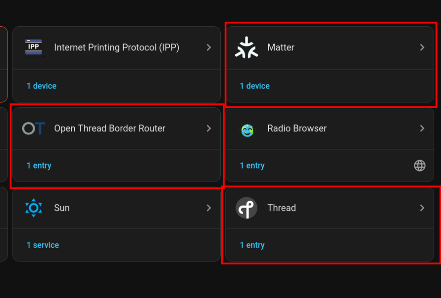

Once restarted, home assistant should detect the Open thread border router, the corresponding Thread network and the matter server automatically and propose to add them as integrations.
At this point you should be ready to commission your first device.
