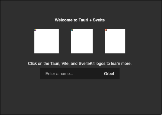

Also with the current shell.nix (no fhs) the webview is not rendering properly for the default app created by create-tauri-app
https://files.catbox.moe/dzx1bw.png Mach50 (talk) 20:00, 11 December 2025 (UTC)Reply
