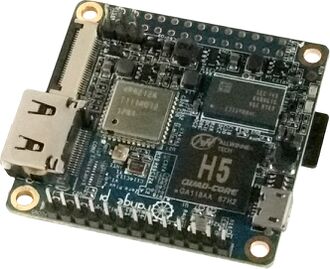

An Orange Pi Zero Plus2 (H5).

Upstream NixOS AArch64 image will boot on the Orange Pi Zero Plus2 (H5), using the proper upstream u-boot.
First follow the generic installation steps to get the installer image on an SD card.
U-Boot needs to be copied to specific sectors on the microSD card with dd. Download u-boot for the board, and copy it to the correct location with (again, replace /dev/sdX with the correct path to the SD card device):
sudo dd if=u-boot-sunxi-with-spl.bin of=/dev/sdX bs=1024 seek=8
