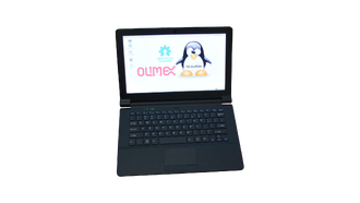

Teres-1 (often referred as teres-a64) is an open-source hardware and software netbook design based on the Allwinner A64 SoC.
OLIMEX Teres-A64
The King Himself
Manufacturer OLIMEX, Ltd
Architecture AArch64
Bootloader Upstream U-Boot[1]
Boot order SD, eMMC
Maintainer KREYREN
It can boot from SD or from the included and slow af eMMC module (insane people use only).
